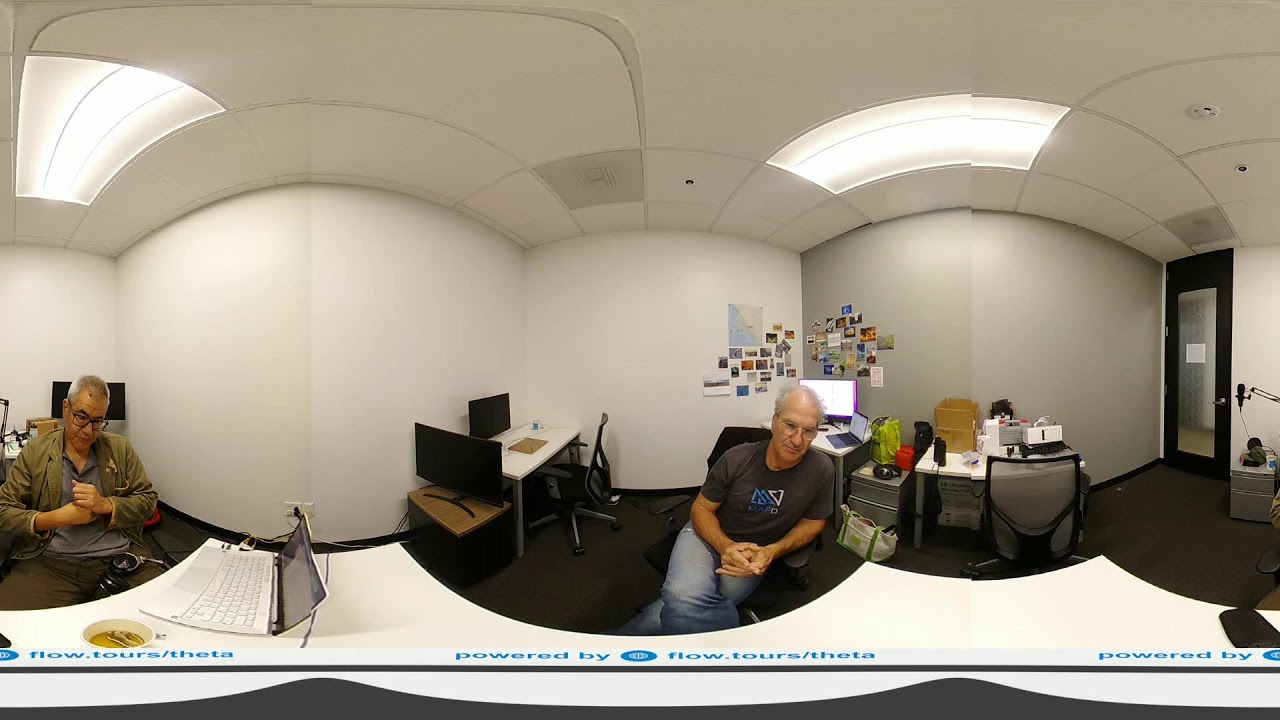

1 hour live stream with no problems!
thanks for sharing! It was a bit late for me, but opened the stream a bit from my mobile phone and it worked fine, was looking nice here. Next time we could make this a real meeting, so that audience could also talk to you…hopefully on flow.tours .
Also I think I could increase a bit microphone gain too.
Stitching correction is on my radar for sure…
Thanks again for live streaming! Good thoughts and information shared during this event.
We can try it on FlowTours at 9am PT, which is 5pm in Hungary. California will fall back off of daylight savings on Nov 6.
So, the time may be different in Hungary in a couple of weeks.
If there was a way to increase the microphone gain, that would be great.
What height level should I place the camera. Is the plug-in optimized for around a 30cm below eye level?
I’m going to lower the camera in the next live event.

we are back already of daylight savings on 30th October. We can meet a bit later today at 10:30am PT, if it works for you? I’m a bit sick with sore throat and feel a bit miserable, but my attitude is as good as possible for a chat. I may rather not use webcam at this time. :slight_smile: just audio if not a problem. I’ve so many things to accomplish, tuning a bit the plugin but even more on flow.tours.
I’m experimenting with an audio gain preset but it would work only if streaming towards flow.tours, also in camera could work by manipulating audio PCM data directly, but not sure about the timing of that.
at the moment in Z1, better to stay closer to the camera, best if camera is close to the eye level, maximum 30 cm below I would say.
In theory it can handle multi channel audio too, it’s not implemented, but I was looking into earlier. What would be the source of that second channel audio? Or you refer to spatial audio here? It could work, but that may require more tweaks also in plugin. This would be another project in size honestly, to understand how Z1 stores audio data by default… I’m not an expert on this for now.
