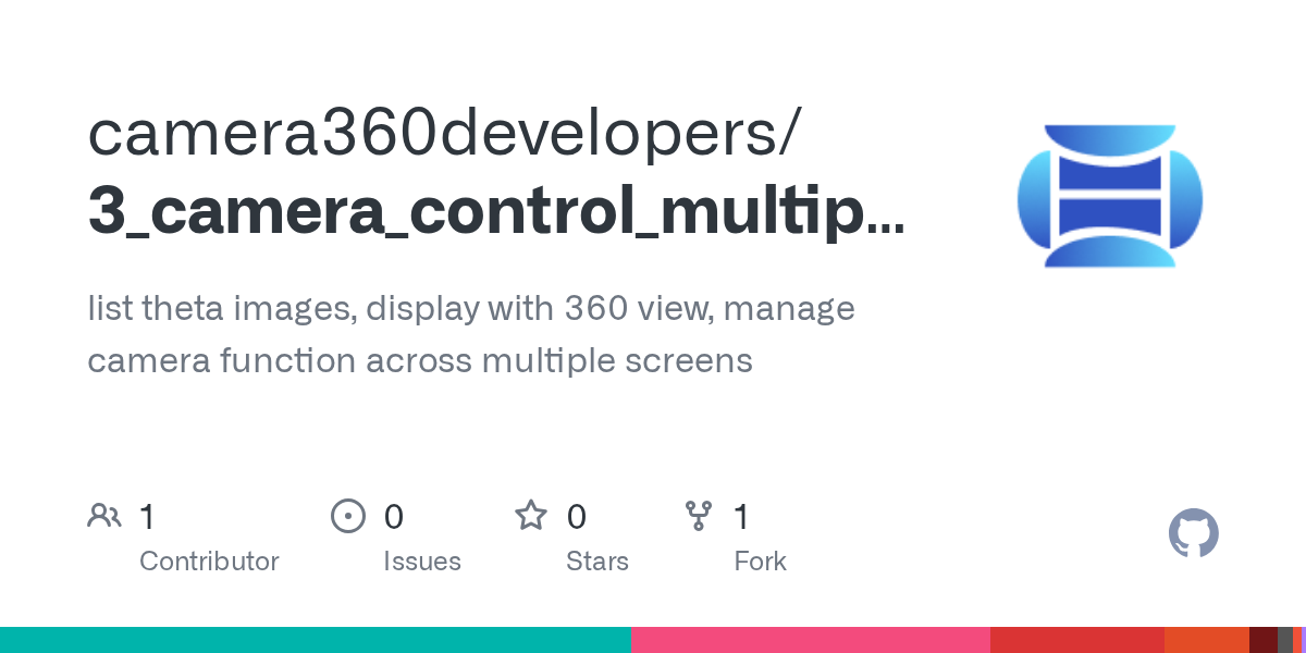

Did you try the Flutter code? The THETA X is the main development camera for the Getting Started Guide and Android Pixel 2, 3, 4 are the main phone test units.
This is a simple example:
https://starter.theta360.guide/03-ricoh-theta-api-app-state-management-with-bloc/
list theta images, display with 360 view, manage camera function across multiple screens
I’ll look at the Android SDK from RICOH and test it with the X.
