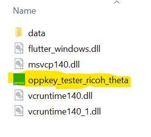

First, I tested using a standalone Flutter app for Windows. I loaded it on my Dell XPS 13 7390 running Windows 10. I got it as a zip file and unzipped it.

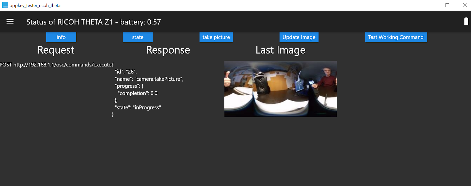

In order to test it, I have to connect my laptop to my Z1. I double click the executable. It works on the first try.

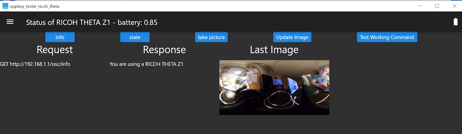

I can run the info command, find state, take a picture, and more. It shows the battery level both numerically (in the title) and with an icon (far right).

I enable for Windows desktop. And when I do flutter run -d windows, it runs!
That’s me with a thumbs up in the picture.
