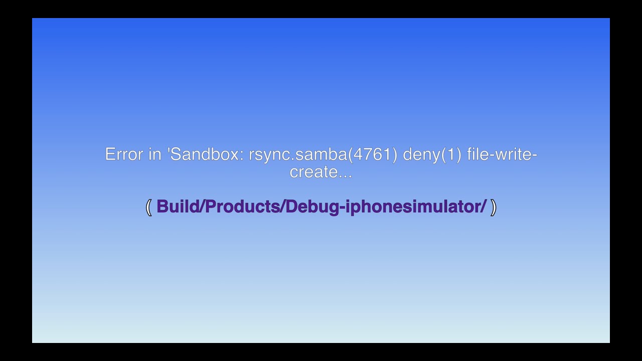

I ran into an error with the build.
Error: Sandbox: rsync.samba(4761) deny(1) file-write-create /Users/your_user_name/Library/Developer/Xcode/DerivedData/
This video solved the problem.
The main thing that I needed to do was to disable User Script Sandboxing.
At this point, theta-client, demo-ios works normally.
