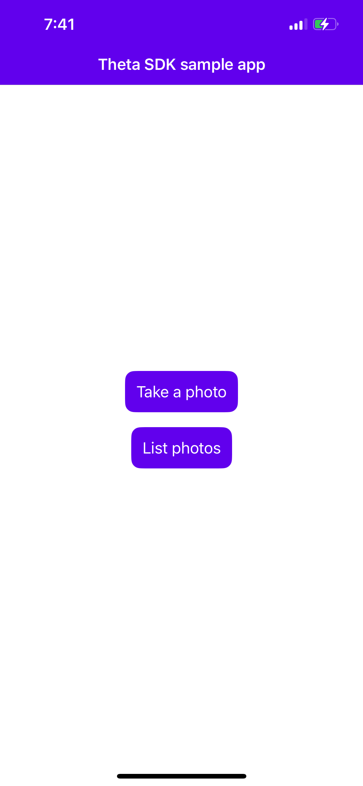

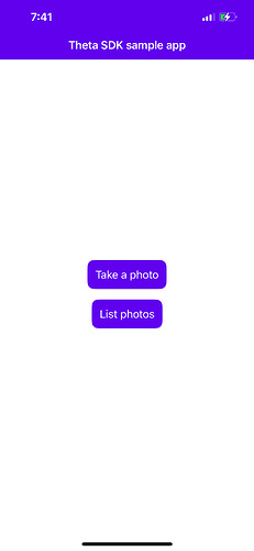

After the initial build on the physical device with XCode, the theta-client app loaded as expected.

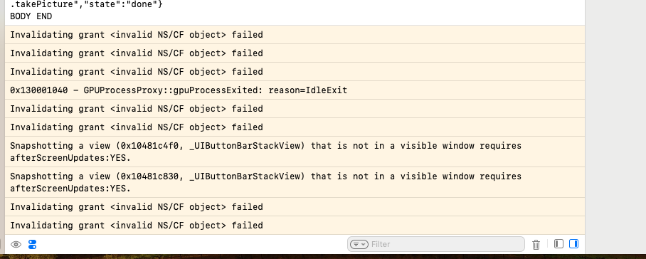

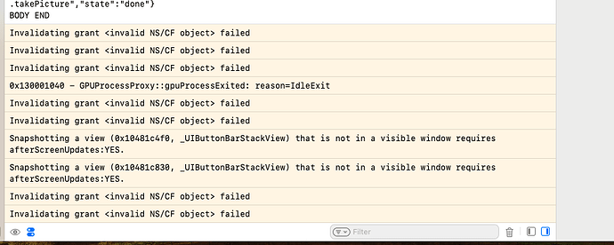

The iPhone and THETA X are only separated by a meter. Pressing the ‘Take a Photo’ button on the device with the WiFi connected to the THETA X camera, worked appropriately. The log outputted the warnings shown below, but it didn’t interfere with the app’s functionality.

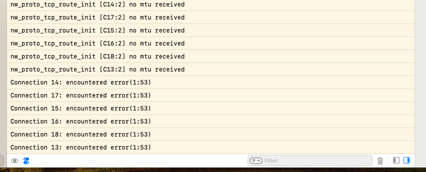

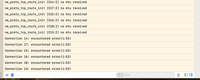

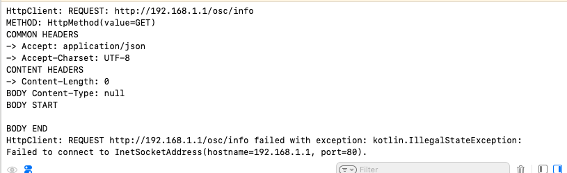

While the app was running, I disconnected the mobile device from the THETA X’s WiFi and reconnected my device to a router. Now, the log outputted the failed to connect error. I received a series of Connection errors when trying to take a picture as shown below. I replicated this procedure and got the same output.
Screenshot 2024-08-01 at 7.31.34 AM
Test #3: Testing the Internet Connection with iPhone WiFi Disabled
I disabled the iPhone WiFi and received the same Connection output displayed above in the screenshots.
Test #4: Turning off the THETA X WiFi
Turning off the THETA X WiFi also outputs the failed to connect error.

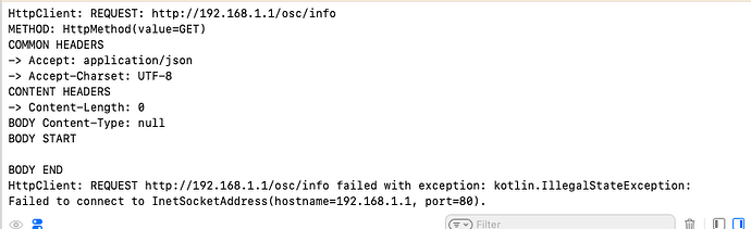

If you disconnect the THETA and the iPhone and then run info, does this error come up?
The Internet connection appears to be offline.,
    NSErrorFailingURLStringKey=http://192.168.1.1/osc/i
Maybe this is just the error that is shown from the library when the library cannot reach the network endpoint? We can try and use the same iOS library and see if we can replicate the error.

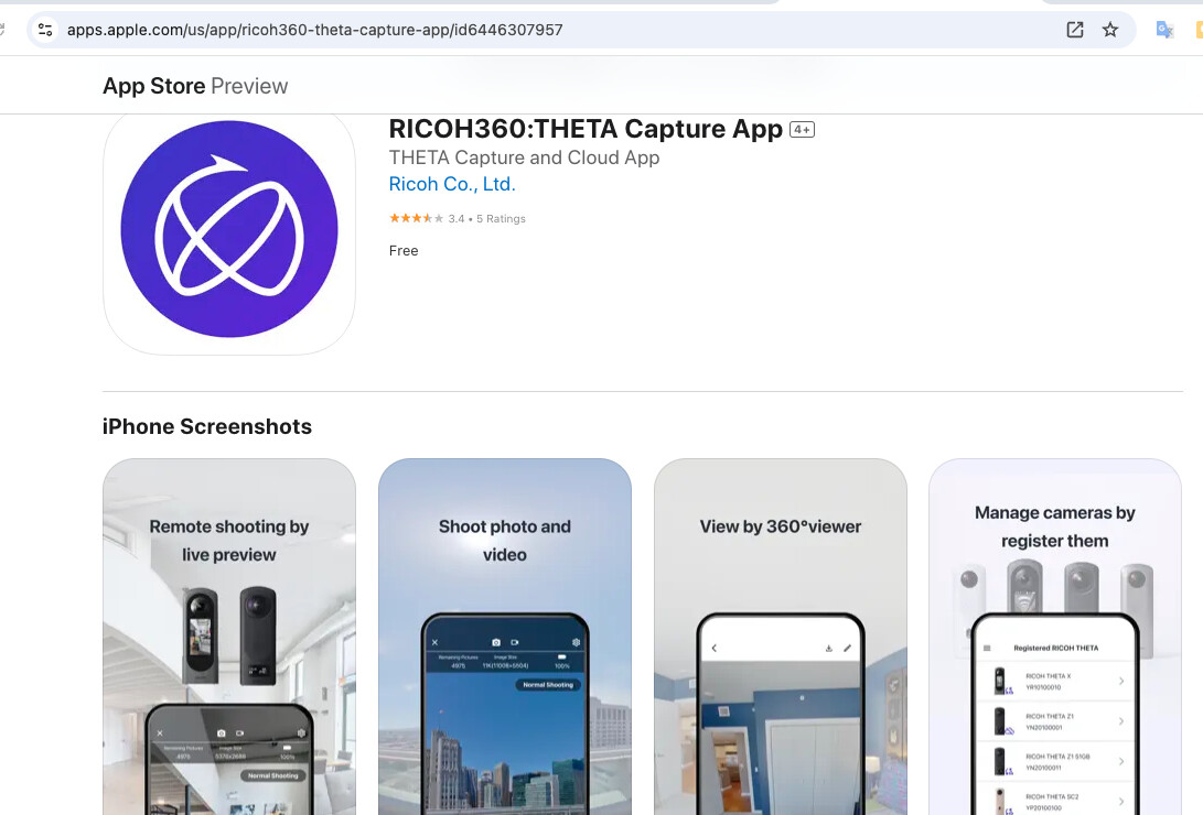

Additionally, it may be easier to get information from the RICOH360 App instead of the RICOH THETA app.
I wonder if we could test the RICOH360 App in addition to the RICOH THETA app?
Could you please clarify which exactly app you mean? Could you send link to the AppStore?
The RICOH360:THETA Capture App appears to be under active development.
