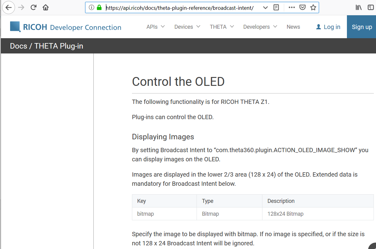

The obvious solution is to use the display panel on the Z1 to show color temperature adjustments.

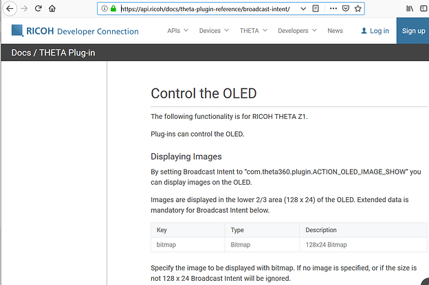

The RICOH documentation on the plug-in shows the use of broadcast intent to control the OLED display of the Z1.
https://api.ricoh/docs/theta-plugin-reference/broadcast-intent/

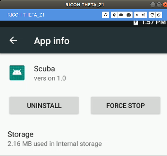

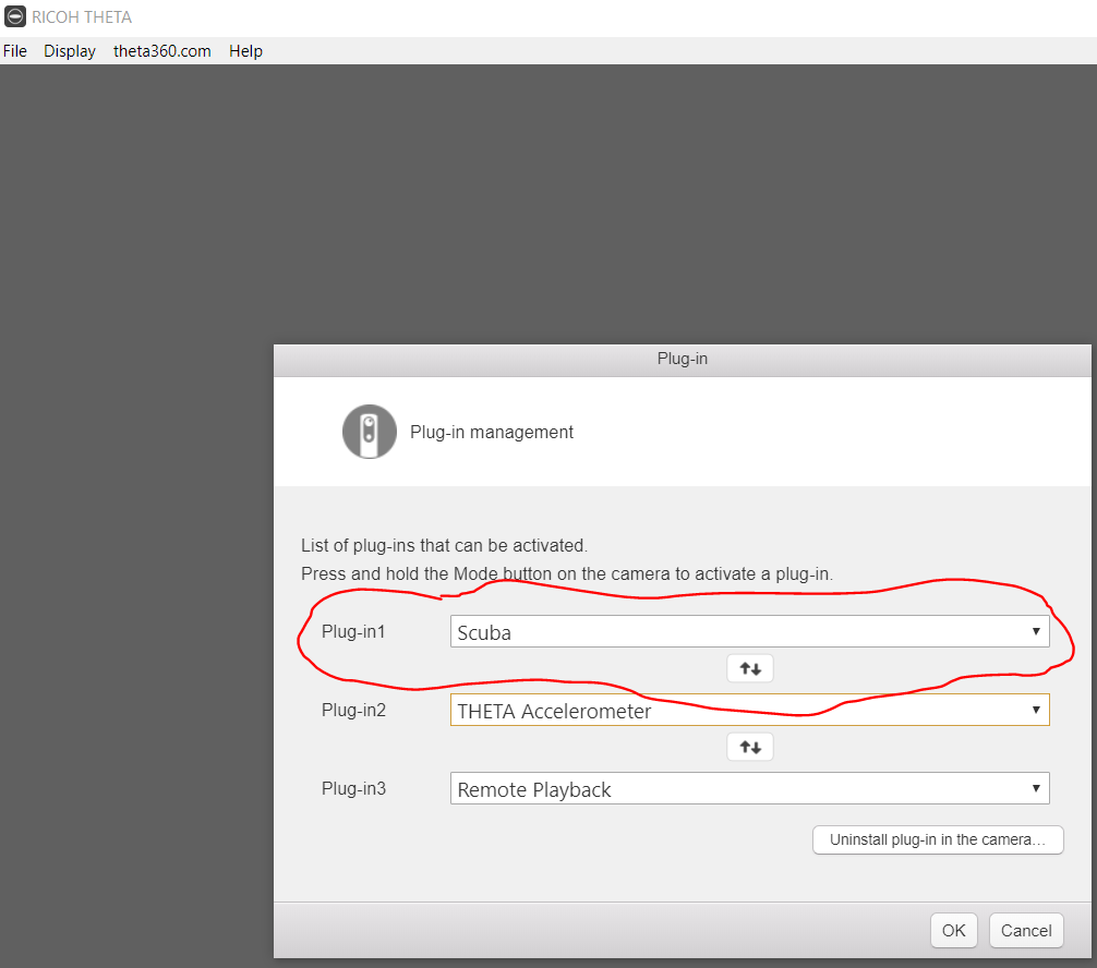

The SCUBA plug-ininstalled into the Z1 with no problem. As it’s not in the store yet, I used adb to install the plug-in. I set the default plug-in can with the mobile app.
It will then appear on the camera display.
You can also use the desktop app with a USB-C cable to set the boot plug-in.

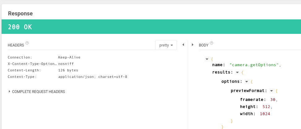

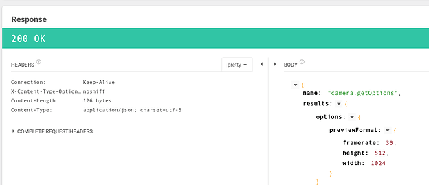

RICOH THETA Wi-Fi API Tests
As I have a cheap Wi-Fi dongle that only supports 2.4GHz, I used the mobile app to change the Wi-Fi frequency of the Z1 to 2.4GHz. All the OSC APIs work great both from Wi-Fi and from inside the plug-in.

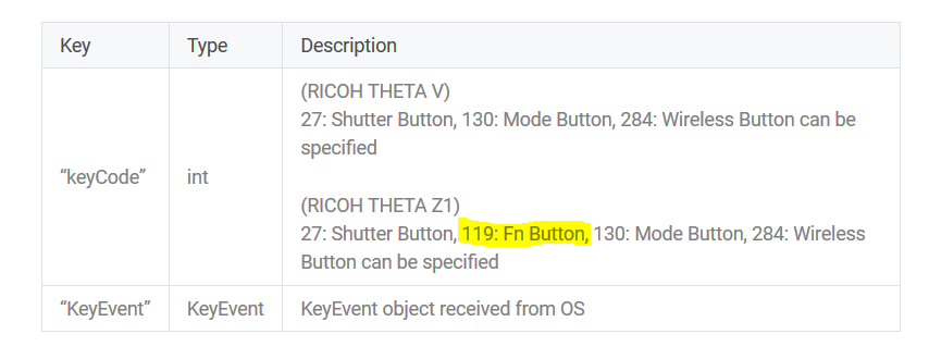

As there’s only one LED, most of the feedback will need to come from the OLED display. The Z1 also has an additional function button that can be accessed with keycode 119.

- THETA Z1 has an OLED display - How To article on OLED customization
- Z1 Fn button - How To article on using Fn button
