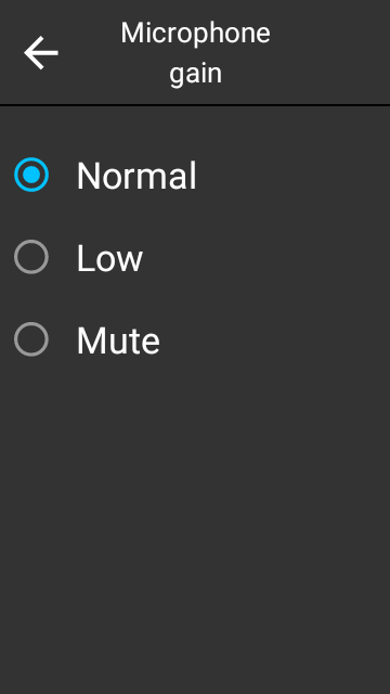

・“Mute” has been added as an option for “Microphone gain” in the video shooting settings. This option can be used when you do not want to record audio during video shooting.

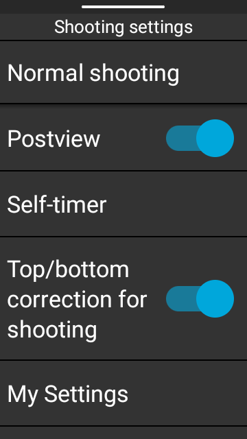

・“Top/bottom corr. for shooting” has been added to the still image shooting settings. The top/bottom correction can be turned off if necessary.

auto-corrected
disable Top/bottom correction for shooting
correction not performed

Mute microphone
