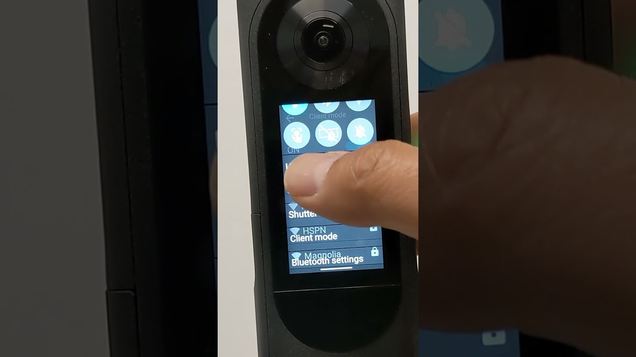

Easy Client Mode Setup and Connection
With the LCD of the THETA X, the client mode setup process is almost as easy as connecting a mobile phone to WiFi. People can use the camera LCD to visually select the WiFi hotspots to connect to.
Easy Firmware Upgrade - No Other Software Needed
Clear menus guide people through the firmware upgrade process.
RICOH recommends that you connect the camera with a USB cable to power the camera during the upgrade process.
Firmware is upgraded directly from the Internet into the camera.
Installation is automatic. Once the install is completed, you can verify that you have the most recent firmware using the LCD screen.
