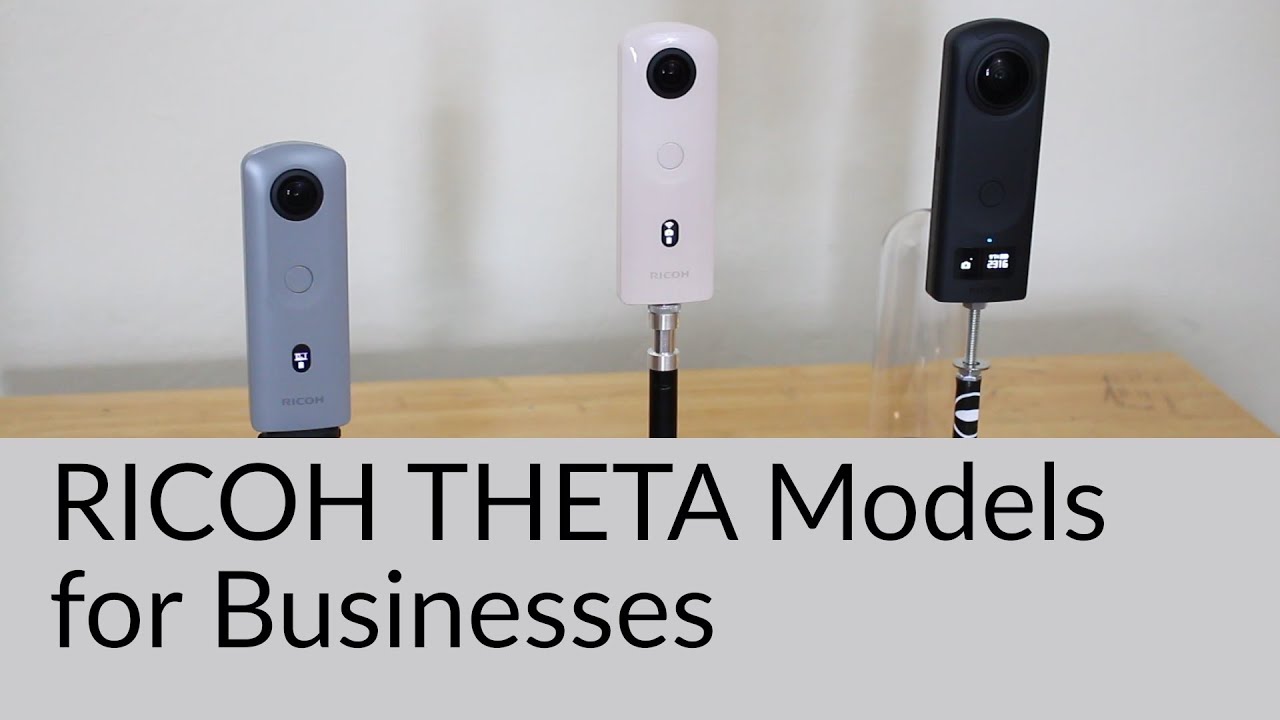

This is a common type of question from astute business managers. I’ve produced a video that helps answer some questions and provides my own personal opinion on the best camera for different business use cases.
