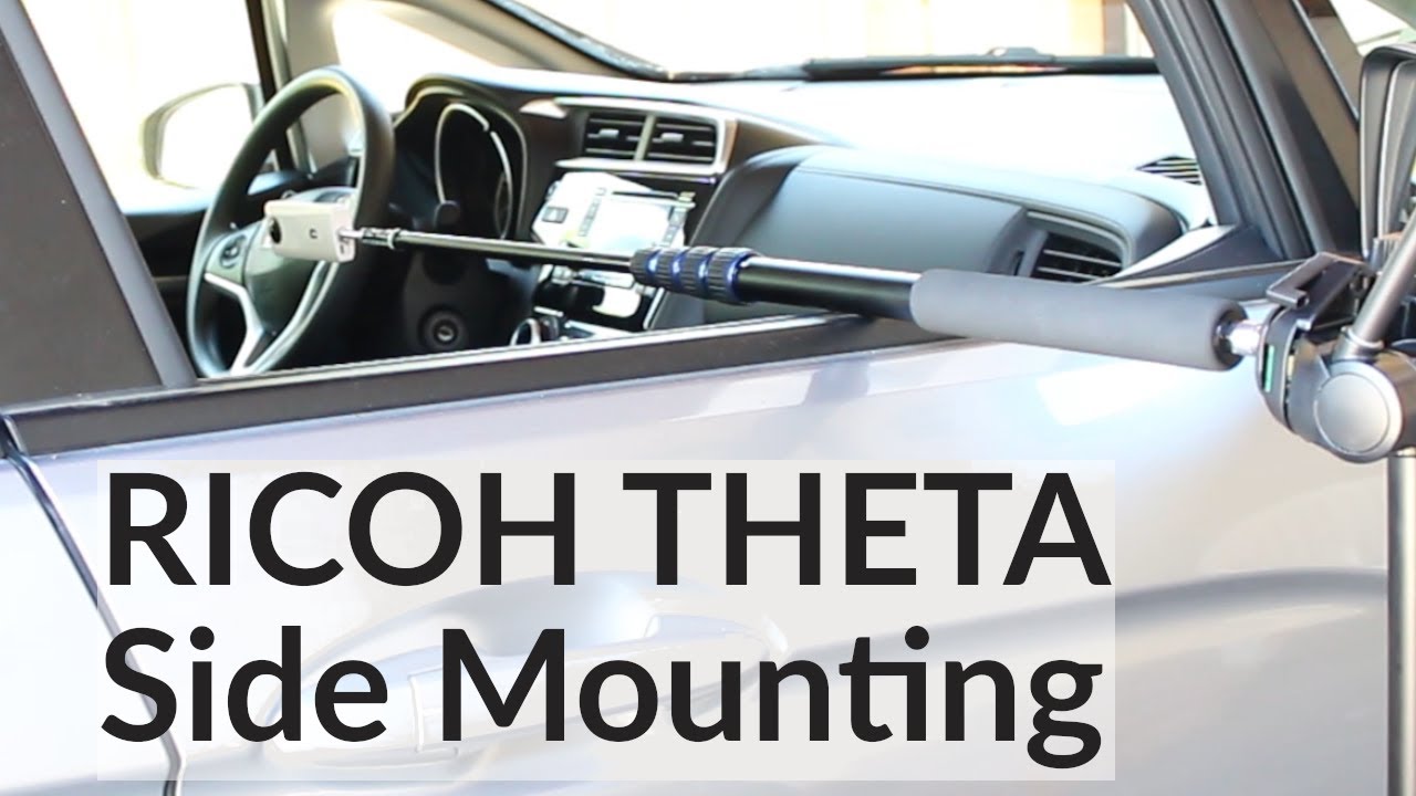

Mounting Adaptor
I received a question about how to attach the RICOH THETA to the skinny end of the monopod.
I am using this package of adapters for $14.
Amazon.com: muscccm Camera Screw, 22 Pcs Tripod Screw Adapter Converter Screws Pack : Industrial & Scientific
For my monopod, I’m using the 3/8" male to 1/4" male adapter

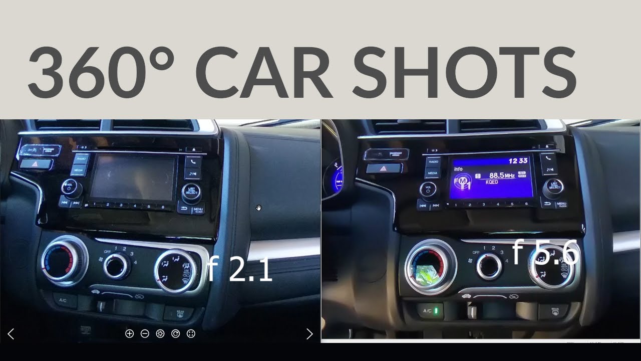

aperture

Lens Orientation - lens pointed front to back for more detail
by Cristiano P. Ferreira and Huub Vt Pad Bosch

For car interiors. Very quick setup mounting the monopod on a lightstand using a clamp.
Minimal stitched footprint, easily removed in post. Sorry for the low-res screenshot.
The 3 x 200g foot-mounted weights allow the monopod to be perfectly balanced on the lightstand and allow for greater extension of the shaft without putting any torsion on the clamp.
Nice use of the counterweights. You could use that setup for high volume used car shots in an assembly line of cars. This reduces the guesswork of placing the camera on a small tripod in the vehicle. The interior placement varies per car type.
