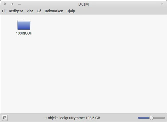

here is how it looks when you connect the THETA to a Linux machine
the .trash folder are not seen on Mac but on Linux you just click Ctrl+h
Show hidden files and folders
