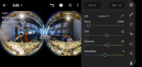

Dear Craig , here is another Mobile HDR-DNG Workflow with DualFisheye Plugin
For your information , to simplify , the workflow is as follows:
  1. USB typeC to typeC cable connect
    your phone and RICOH THETA Z1
  2. Copy the xxx_HDR.DNG to your phone
  3. Import these DNG files to
    Adobe Photoshop Lightroom Mobile
  4. Do some post processing in Lightroom
  5. Export as JPG/TIF with all metadata
  6. (Batch) Stitch in THETA Z1 Stitcher
    with fully automatically level correction
  7. Touchretouch APP to make nadir patch
