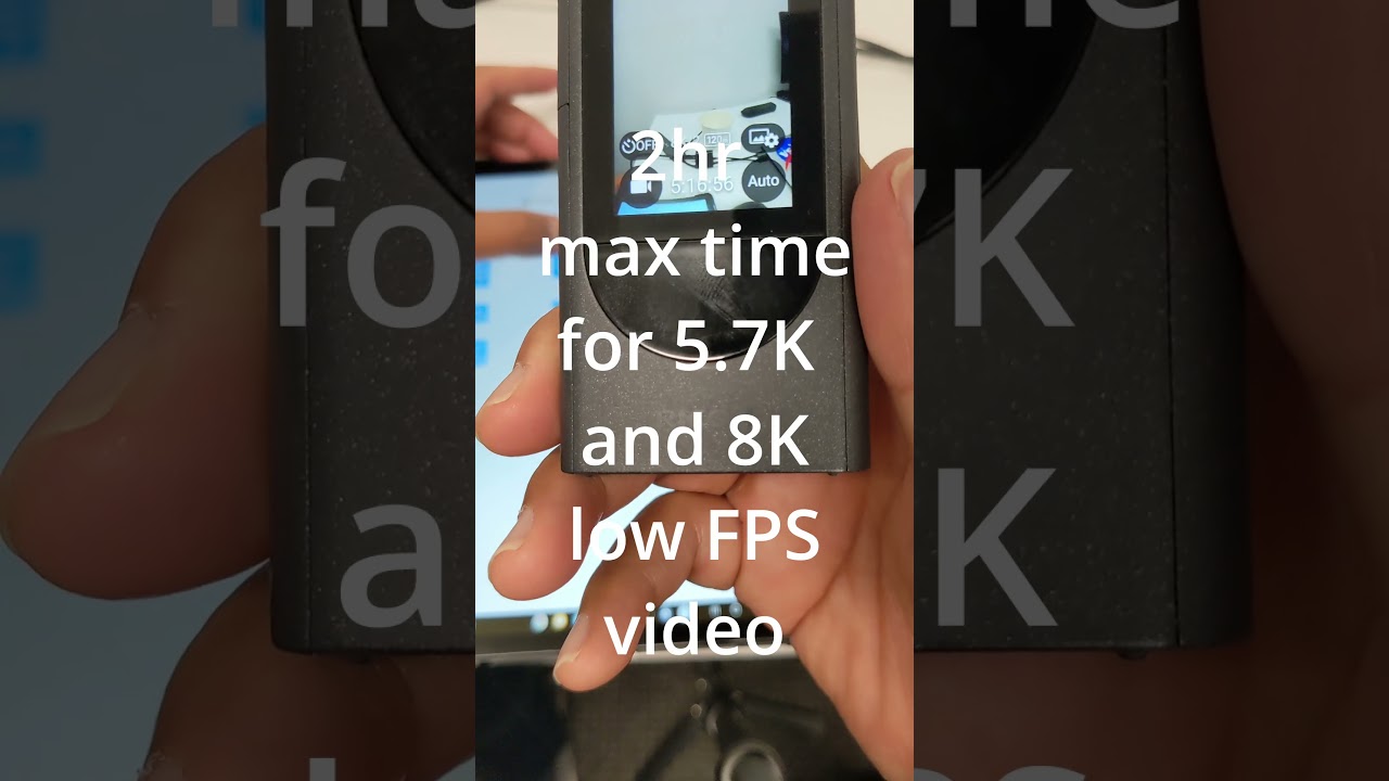

I uploaded an apk of the application.
30 second video of app by @erikrod1 running on Samsung tablet.
I am using a Pixel running Android 10. It installed and worked great. It’s pretty cool how easily it runs on a physical device, not just an emulator.
