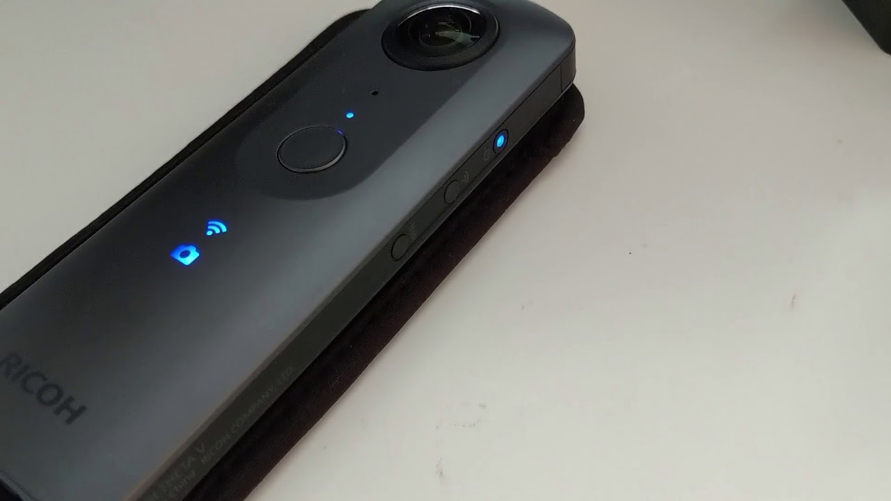

Theta S on latest firmware is stuck in HDR mode, when shooting without smartphone. And I can’t find ways to turn HDR off. Please help

Power Off Camera with 8 second button press
Press and hold the power button for 8 sec or longer. Camera will turn off. Turn it back on.
Connect with mobile app
Connect with the official THETA mobile app using your camera as the hotspot. The camera blue WiFi LED will be flashing.
Set default shooting mode to normal mode
