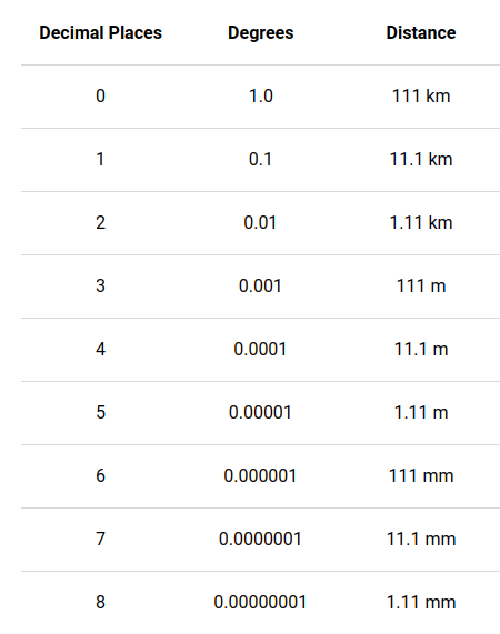

    GPS location stored in the image metadata is in the Exif IFD format, which has the following accuracy: Lat/Lng dd/1 mm/1 ss/100. This is roughly equivalent to 30cm.
Understanding GPS Numbers
accuracy information: source
