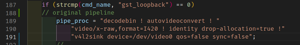

if (strcmp(cmd_name, "gst_loopback") == 0)
    pipe_proc = "decodebin ! autovideoconvert ! "
        "video/x-raw,format=I420 ! identity drop-allocation=true !"
        "v4l2sink device=/dev/video1 qos=false sync=false";
On Xavier, you may need to specify the decoder, instead of decodebin ! autovideoconvert The pipeline below is only for Jetson, not x86.
"nvv4l2decoder ! nv3dsink sync=false"

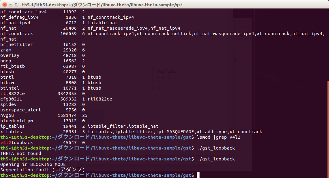

We faced a problem when we used JetsonNX+ThetaZ1. The gst_viewer works well, but the gst_loopback doesn’t work with an error msg. of internal data stream error.
Although we confirmed others also faced the same problem and solved that, we are still confusing how to fix this problem. Would you please give us some opinions?
Please confirm that you’re running v4l2loopback and loaded the module with sudo modprobe v4l2loopback
What is the output of lsmod |grep v4l2
Thank you very much for your reply.
We took the screenshot. We loaded the module and output also showed correctly lsmod |grep v4l2.
But the error still occurred.
Does any other considerable problem exist?

Thank you for your reply.
We checked what you mentioned.
First, we executed lsusb, the output was 2715. But the device name only showed Ricoh Co., Ltd without the camera type.
Second, in the gst_viewer.c was correctly edited, /dev/video0 was shown.

In the pipeline in the gst_viewer.c code, try to replace
  • decodebin with nvv4l2decoder
  • autovideoconvert with nvvidconv

We tried to instead those codes as you mentioned in gst_viewer.c and then ran the command again. It shows that gst_loopback opening in blocking mode and segmentation fault.
Does it work with this:
	pipe_proc = "nvv4l2decoder ! autovideoconvert !"
Unfortunately, I don’t have an NX, but the nvv4l2decoder ! autovideoconvert ! works on the Nano.

We tried your codes, but the problem still exits shown as below.
The segmentation fault still occurred. We confirmed the firmware version of 2.00.1.
Now we haven’t got a 32-bit Linux PC, so we can’t compare with it instantly.
