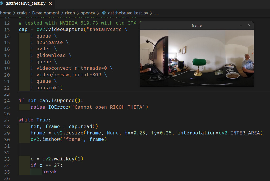

@dvzt
This works
import cv2
# pipeline below worked
# cap = cv2.VideoCapture("thetauvcsrc \
#     ! decodebin \
#     ! autovideoconvert \
#     ! video/x-raw,format=BGRx \
#     ! queue ! videoconvert \
#     ! video/x-raw,format=BGR ! queue ! appsink")
# pipeline suggestion thanks to nickel110
# attempt to force hardware acceleration
# tested with NVIDIA 510.73 with old GTX 950 on Ubuntu 22.04
    ! queue \
    ! h264parse \
    ! nvdec \
    ! gldownload \
    ! queue \
    ! videoconvert n-threads=0 \
    ! video/x-raw,format=BGR \
    ! queue \
    ! appsink")
if not cap.isOpened():
    raise IOError('Cannot open RICOH THETA')
while True:
    ret, frame = cap.read()
    frame = cv2.resize(frame, None, fx=0.25, fy=0.25, interpolation=cv2.INTER_AREA)
    cv2.imshow('frame', frame)
    c = cv2.waitKey(1)
    if c == 27:
        break
cap.release()
cv2.destroyAllWindows()
Approximately 450ms latency when used with Python script above and stream processed with OpenCV per the cv2.resize above.
Canny Edge Detection
Gray scale, Gassian Blur, and Canny Edge simultaneously.

@craig Its working well, thank you for the example, and the performance is quiet good
Nice! Great to hear. :slight_smile:
Is the performance noticeably better with nvdec and glimagedownload?
You have a much faster computer and GPU than I do. Are you using CUDA with OpenCV? I was doing some work with CUDA a while ago, but stopped as it was a little difficult for me, but it was faster.

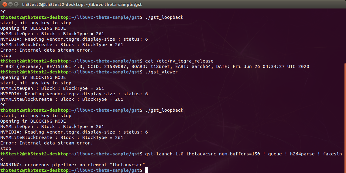

@craig
We apologize for our late reply, and we would like to report our current situation.
Although we downgrade our Jetpack from 4.5 to 4.3, the same error still appeared.
(gst_viewer worked correctly, but gst_loopback didn’t work)
We ran the command “gst-launch-1.0 thetauvcsrc num-buffers=150 ! queue ! h264parse ! fakesink”, it showed waring with “erroneous pipeline: no element thetauvcsrc”.
Since we haven’t read Basic tutorial thoroughly, we would like to debug the plugins later.
Did you install additional software after you installed JetPack? Do you have another version of libuvc installed?
Do you have the gstthetauvc.so installed in gstreamer-1.0 and not in gstreamer1.0?
sudo cp gstthetauvc.so /usr/lib/aarch64-linux-gnu/gstreamer-1.0/
What is the output of make?

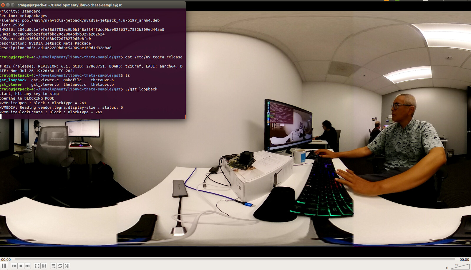

@iketani_takuya
I have streaming on my Jetson Nano working now with Jetpack 4.6.
Try uninstalling docker and make sure the camera is not mounted. Maybe something is interfering with the USB connection to the camera?
mkdir build
cd build/
cmake ..
sudo make install
Install the project...
-- Install configuration: "Release"
-- Installing: /usr/local/lib/libuvc.so.0.0.6
-- Installing: /usr/local/include/libuvc/libuvc.h
-- Installing: /usr/local/include/libuvc/libuvc_config.h
-- Installing: /usr/local/lib/libuvc.a
-- Up-to-date: /usr/local/include/libuvc/libuvc.h
-- Up-to-date: /usr/local/include/libuvc/libuvc_config.h
-- Installing: /usr/local/lib/cmake/libuvc/libuvcTargets.cmake
-- Installing: /usr/local/lib/cmake/libuvc/libuvcTargets-release.cmake
-- Installing: /usr/local/lib/cmake/libuvc/FindLibUSB.cmake
-- Installing: /usr/local/lib/cmake/libuvc/FindJpegPkg.cmake
-- Installing: /usr/local/lib/cmake/libuvc/libuvcConfigVersion.cmake
-- Installing: /usr/local/lib/pkgconfig/libuvc.pc
-- Installing: /usr/local/lib/cmake/libuvc/libuvcConfig.cmake
sudo ldconfig
sudo modprobe v4l2loopback
lsmod |grep v4l2
v4l2loopback           37127  0
ls -l /sys/devices/virtual/video4linux/
total 0
drwxr-xr-x 3 root root 0 Jul  6 15:18 video0
./gst_loopback
start, hit any key to stop
Opening in BLOCKING MODE
NvMMLiteOpen : Block : BlockType = 261
NVMEDIA: Reading vendor.tegra.display-size : status: 6
NvMMLiteBlockCreate : Block : BlockType = 261
sudo apt install vlc
sudo apt-cache show nvidia-jetpack
[sudo] password for craig:
Package: nvidia-jetpack
Version: 4.6-b199

cat /etc/nv_tegra_release
# R32 (release), REVISION: 6.1, GCID: 27863751, BOARD: t210ref, EABI: aarch64, DATE: Mon Jul 26 19:20:30 UTC 2021
works on /dev/video0 with vlc

gstthetauvc
did you do this?
and then restart the Jetson?
