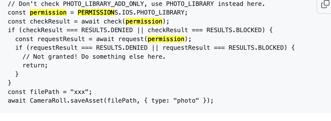

plugin version 7.8.3 - Challenge: We came across a bug in the plugin when trying to use the saveAsset method. The error PHPhotosErrorDomain error -1 kept appearing when attempting to save the image.
- Solution: The solution linked here mentions the plugin @react-native-permissions. Install the plugin and follow the necessary steps to implement the plugin listed in the documentation. KEY POINT: check the permissions with @react-native-permissions right before calling the function
saveAsset
from the CameraRoll plugin. The key permission to check isPERMISSIONS.IOS.PHOTO_LIBRARY

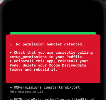

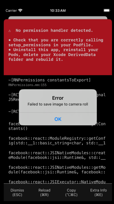

- Challenge: After installing the @react-native-permissions plugin, we received the No Permission Handler detected error.
- Solution: Thoroughly read through the documentation for the plugin linked here. Make sure to edit the Podfile and execute pod install. Then update the Info.plist with the permissions. Run the command npx react-native run-ios` to build the project afterward.

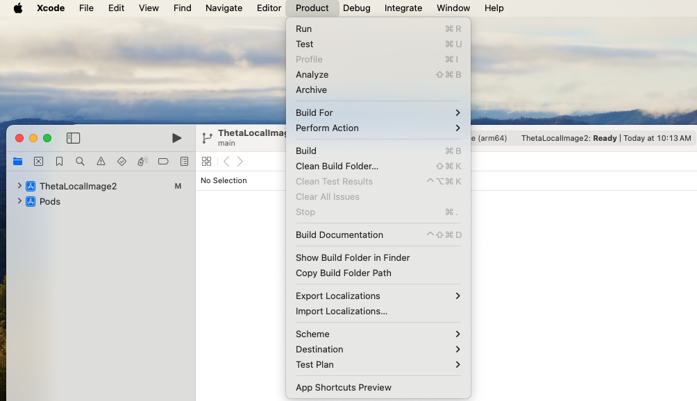

- If you still see the error, you may need to clean the XCode Derived Data. XCode → Product → Clean Project. Then, close the IOS Simulator and run pod install again. Re-run your app.

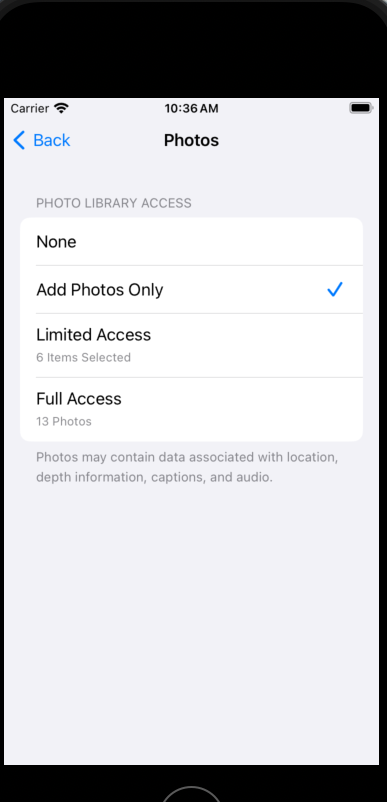

Permission for photo library info.plist to grant access for application to gallery
Additional Information in ios setting if application is set for Add Photos only error occur and would not save image to photo gallery but limited access and full access works fine
