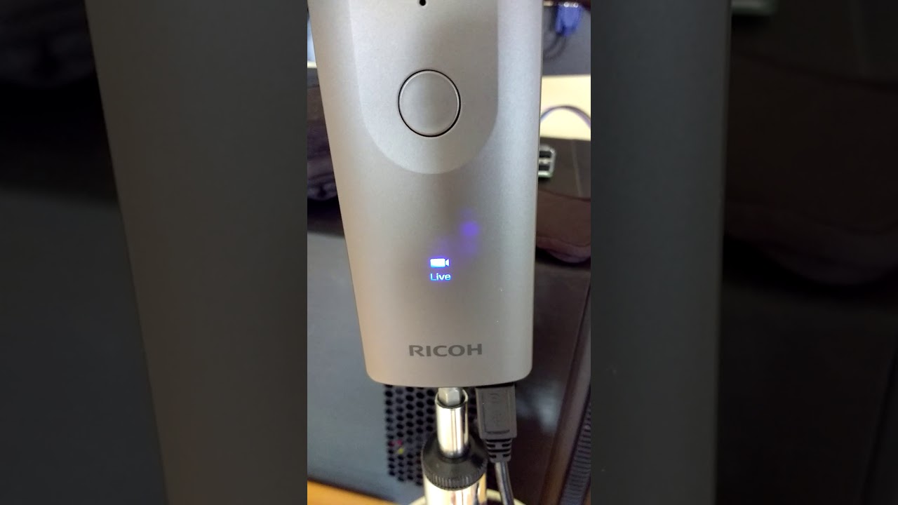

Please confirm that the camera is in Live Streaming mode.
If you don’t see the word “Live” press the lower button.
When the THETA is connected with USB and functioning as a streaming camera, it will blink, like this:
Reset
Press and hold the power and wireless button simultaneously for more than 6 seconds
If you are able to get the THETA V into Live Streaming Mode, but can’t display it in the Mac QuickTime, it is either the USB adapter or the camera.
If you debug the camera with Mac QuickTime, you should be able to also use Ricoh official customer support as the live streaming to Mac is a supported feature.
Yes, it’s in Live Streaming.
