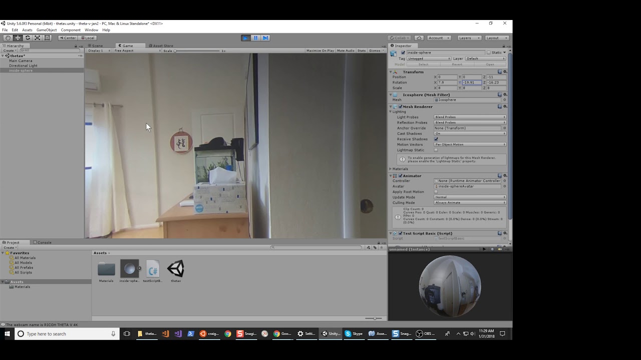

Updated test of 4K streaming on Windows in Unity. Now showing view from inside of Sphere.

  • Did not work on Unity 2017. I’m still using Unity 5.5
  • Could not get code above to work with a normal Unity sphere. I’m using a Blender ico sphere with flip normals
