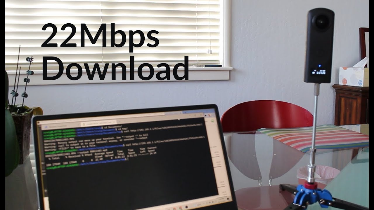

See this test with the Z1.
At 0.5 meters away, I got 22Mbps using 5GHz.
Do you have a THETA V? Can you record a video and test it yourself?
I’m using curl in the test.
Hi, Thanks Craig. I dont have the theta v, i have just seen it has been discontinued. But i am looking for the speed of uploads when the camera is being the client, meaning that when the camera connects to a router. Your test is when the camera is the access point (phone connecting to the camera). For example, gopro has the ability to upload to cloud, but is super slow when acting as a client, and on top of that its not flexible to developers. So, I am looking for a camera which can deliver speed of 100 Mbps to upload the videos, but also if possible upload them onto custom server. I hope i am being at least a bit more clear what i am trying to achieve. Best
