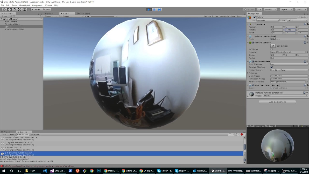

This is a followup to the great @DrustZ post to get THETA UVC FullHD Blender to work in Unity. By using THETA UVC FullHD Blender as the WebCamTexture, youāll be able to render the THETA live stream as a perfect sphere with no adjustment.

Test on Unity
Create a sphere in Unity.
Create a test C# script and attach to the sphere.
I used Visual Studio to make a test script.

On my console, Iām getting an error, but as the test is working, I havenāt tried to fix it.
Everything just works!
Hereās a video clip of my desktop so you can see that the sphere has no gaps in it. No adjustment done.
