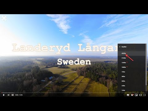

but 4k rendering are finished in the settings it must be a bug !
4k rendering finished
this video are an 8K test on my MC channel
The video are stitched in Insta360 Studio 2020 Bg. Music: Yiddish Dance Cyber Link Power Director Custom size 7680x3840 8K Recorded in 5.7 K Edited in Cyber Link Power Director18 (64-bit) Rendered with a custom build template 7680x3840 Video Length 00:03:20 7680x3840 8K Data rate 35268 kbit / s Frame rate 29.97 frames / second Sound Bit rate 128 kbit / s 48,000 kHz channels 2 (stereo)
