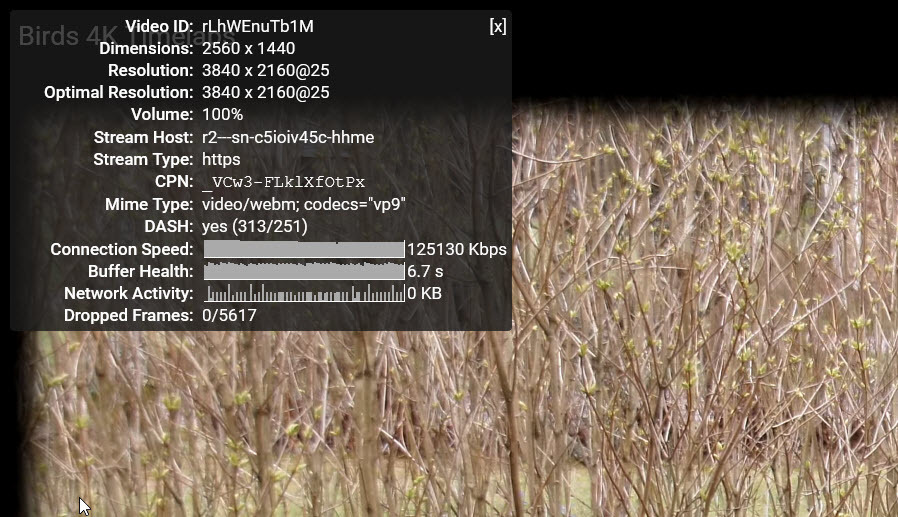

With a picture every 2 seconds, how many frames did you use per second in the completed timelapse?
The camera used continues to shoot continuously as long as memory lasts
and The trigger is fully depressed.
The Sony (SLT-A55 / A55V) camera captures images at a maximum of approximately 10 frames per second 16 Megapixel
the DSLR timelapse shutter can tricker the camera down to one image sec
the 2 minutes Video are 25P
@codetricity here are the YouTube stats for the @Svendus video.
So to answer your question 25 fps.
