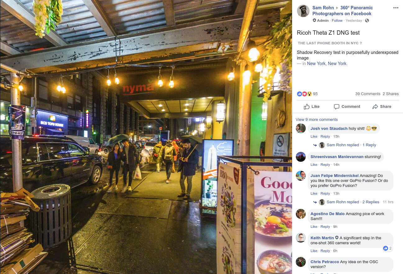

Photographer Sam Rohn recently posted some beautiful pictures taken with the RICOH THETA Z1 on Facebook. He took the images in DNG format and used Adobe Lightroom to edit the images. The results were really impressive! I was able to interview Sam online and got some additional tips.
