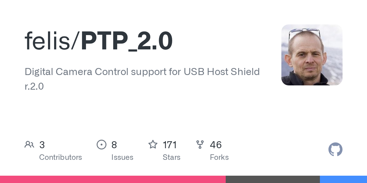

Although it may be possible to modify Oleg Mazurov’s code and example, I agree it may be a lot of work.
There’s many examples using the Raspberry Pi and USB to talk to the THETA. So, although there are problems with the Raspberry Pi, including clean shutdown, you can probably get something up quickly.

  • Appears that there is no easy-example PTP code for Arduino
