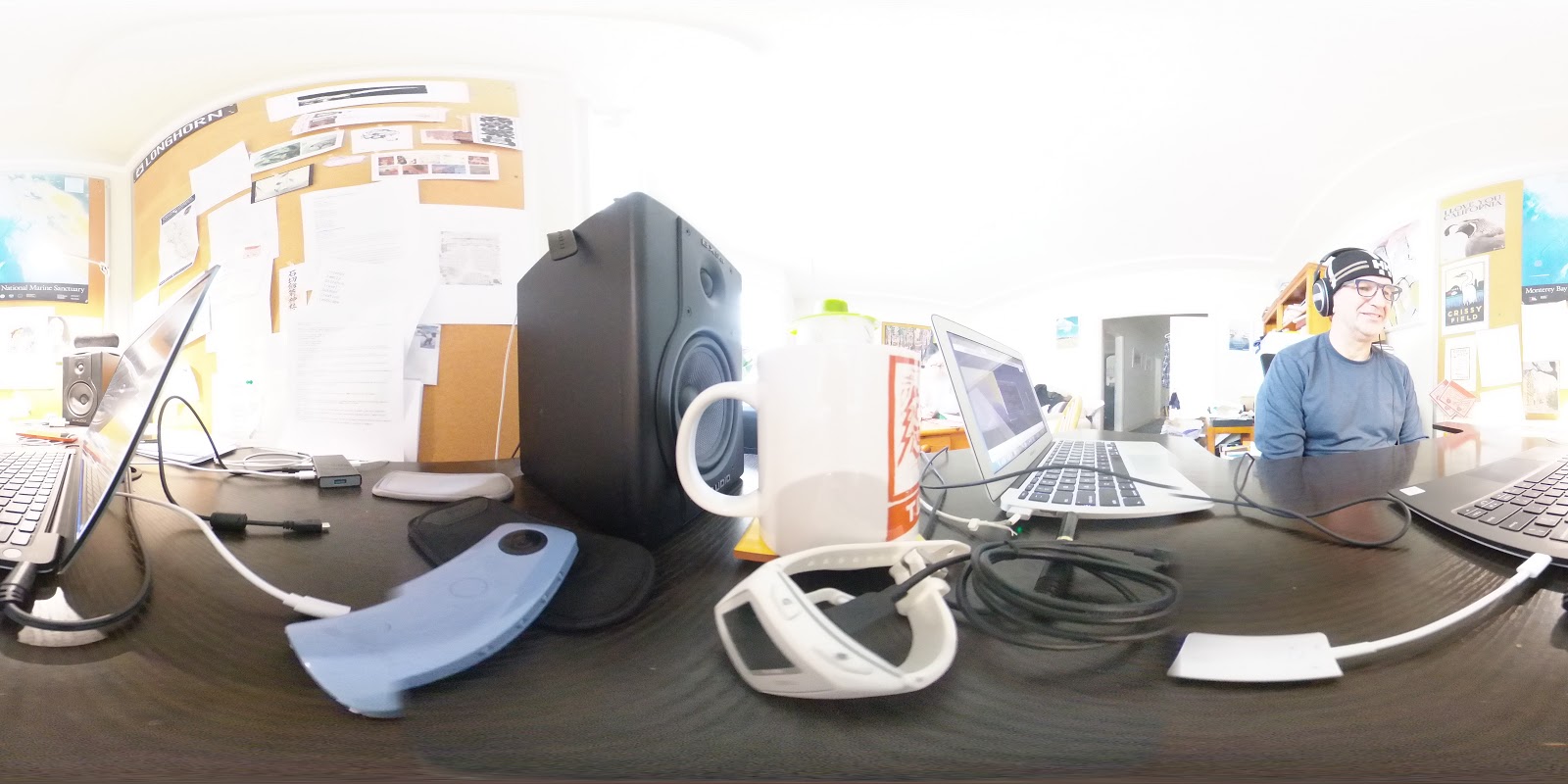

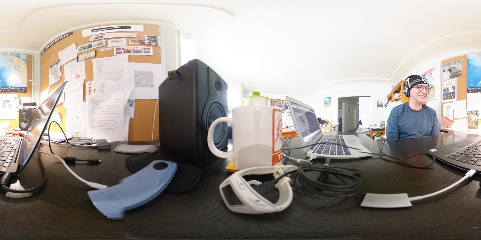

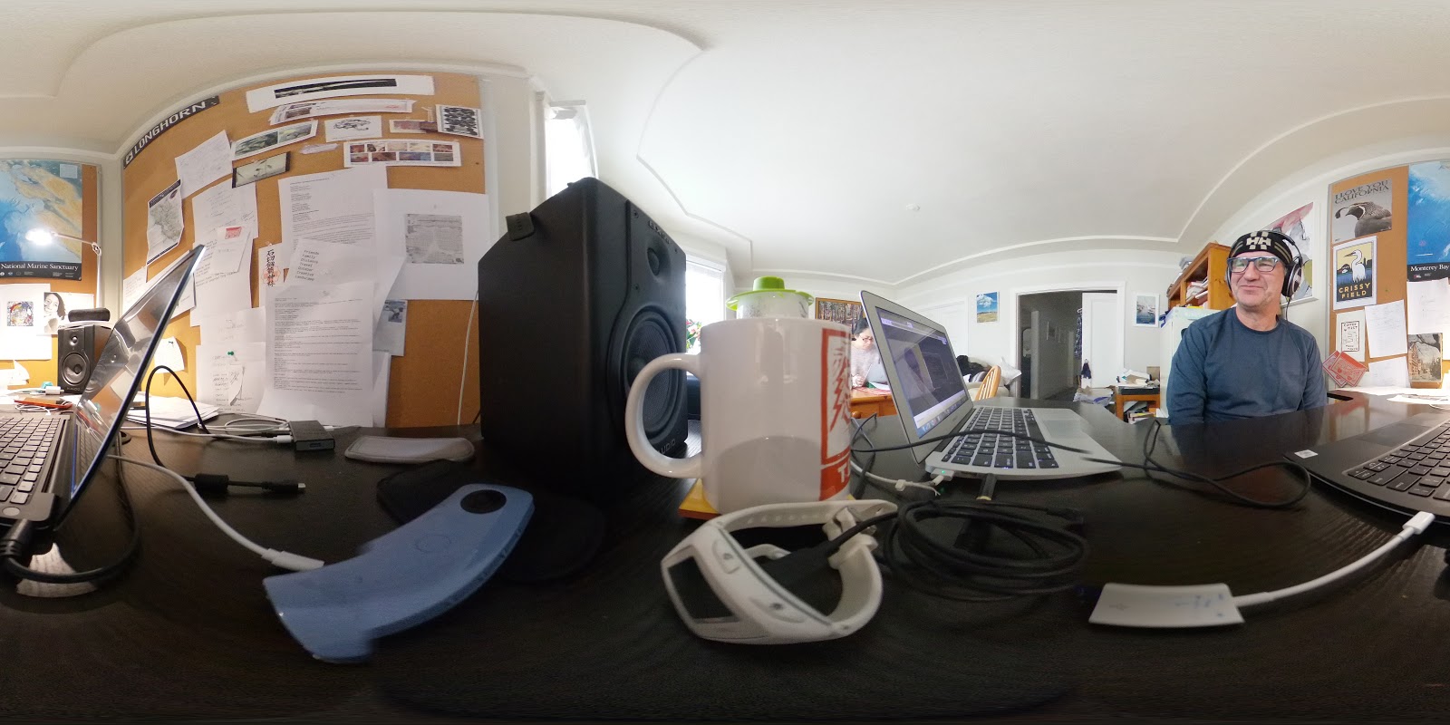

Here’s the output of testing it with a Z1 running firmware 1.60.1

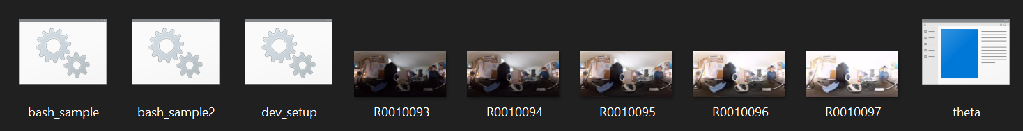

Viewed in Windows Explorer:
The 5 images:
Command line output

The EV is now -2.0. Did it work?  If so, take a moment to celebrate.
Test of taking picture and then checking to see if picture is ready for download
The status ID is 24
Elapsed time: 0 seconds. State: inProgress
Elapsed time: 1 seconds. State: inProgress
Elapsed time: 2 seconds. State: inProgress
Elapsed time: 3 seconds. State: done
picture ready for download at http://192.168.1.1/files/90014a68423861503e0302775cb7b500/100RICOH/R0010093.JPG
Writing file from the following URL
download complete
The EV is now -1.0. Did it work?  If so, take a moment to celebrate.
The status ID is 25
picture ready for download at http://192.168.1.1/files/90014a68423861503e0302775cb7b500/100RICOH/R0010094.JPG
download complete
The EV is now 0.0. Did it work?  If so, take a moment to celebrate.
The status ID is 26
picture ready for download at http://192.168.1.1/files/90014a68423861503e0302775cb7b500/100RICOH/R0010095.JPG
download complete
The EV is now 1.0. Did it work?  If so, take a moment to celebrate.
The status ID is 27
picture ready for download at http://192.168.1.1/files/90014a68423861503e0302775cb7b500/100RICOH/R0010096.JPG
download complete
The EV is now 2.0. Did it work?  If so, take a moment to celebrate.
The status ID is 28
picture ready for download at http://192.168.1.1/files/90014a68423861503e0302775cb7b500/100RICOH/R0010097.JPG
download complete
