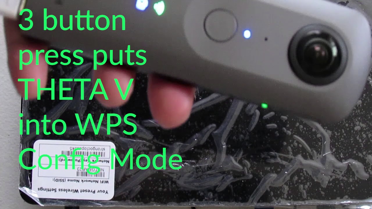

If your router supports WPS, you can configure the THETA V automatically by pressing shutter-wifi-mode buttons at the same time.
Prior to configuring with WPS, please delete old access point configuration information.
Put THETA V into WPS Client Mode Configuration
Put WiFi Router into WPS Configuration
